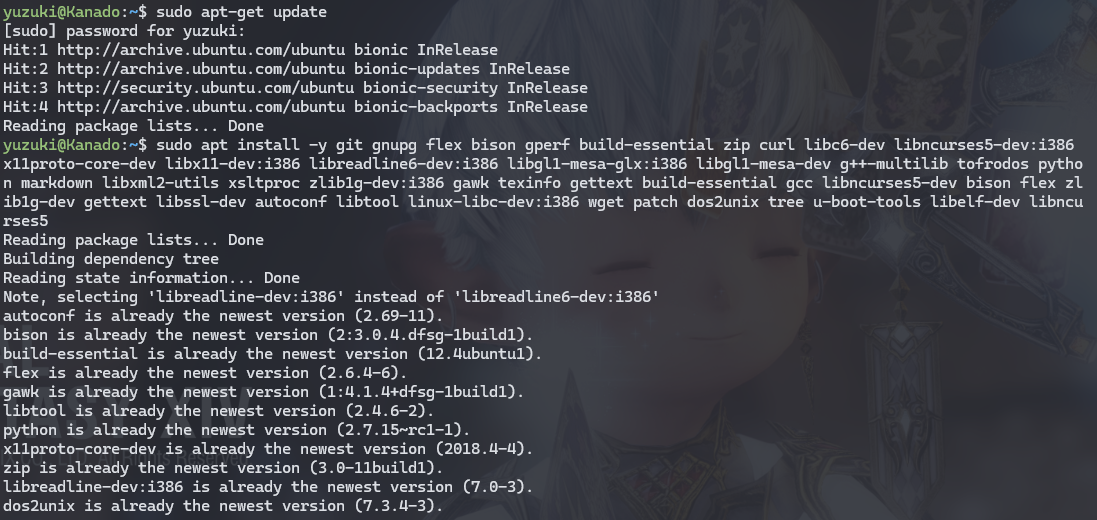

安装软件包
sudo apt-get update
sudo apt install -y git gnupg flex bison gperf build-essential zip curl libc6-dev libncurses5-dev:i386 x11proto-core-dev libx11-dev:i386 libreadline6-dev:i386 libgl1-mesa-glx:i386 libgl1-mesa-dev g++-multilib tofrodos python markdown libxml2-utils xsltproc zlib1g-dev:i386 gawk texinfo gettext build-essential gcc libncurses5-dev bison flex zlib1g-dev gettext libssl-dev autoconf libtool linux-libc-dev:i386 wget patch dos2unix tree u-boot-tools libelf-dev libncurses5
如果出现
E: Unable to locate package libncurses5-dev:i386
E: Unable to locate package libx11-dev:i386
E: Unable to locate package libreadline6-dev:i386
E: Unable to locate package libgl1-mesa-glx:i386
E: Unable to locate package zlib1g-dev:i386
E: Unable to locate package linux-libc-dev:i386
请安装 i386 支持,如下:
sudo apt-get update
sudo apt install gcc-multilib
