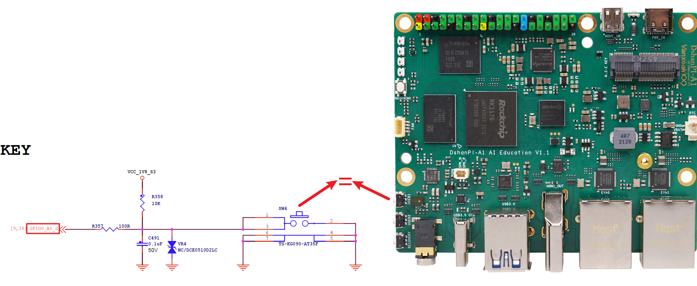

4.2 输入控制示例​
#!/usr/bin/env python3
import gpiod
import time
# gpio0 芯片
chip = gpiod.Chip("gpio0")
# 输出脚:GPIO0_B6 (offset 14)
led = chip.get_line(14)
# 输入脚:GPIO0_A0 (offset 0)
btn = chip.get_line(0)
# 申请输出,默认高
led.request(consumer="led",
type=gpiod.LINE_REQ_DIR_OUT,
default_vals=[1])
# 申请输入,启用下降沿中断
btn.request(consumer="btn",
type=gpiod.LINE_REQ_EV_FALLING_EDGE)
print("上电:GPIO0_B6 = 高")
print("按下 GPIO0_A0 后:GPIO0_B6 拉低,松开恢复高")
print("Ctrl+C 退出")
try:
ev = btn.event_wait(sec=1) # 阻塞等 1 秒
if ev and btn.event_read().event_type == gpiod.LineEvent.FALLING_EDGE:
led.set_value(0) # 按下 -> 低
print("按键按下 → GPIO0_B6 = 低")
# 简单消抖:等待按钮松开
while btn.get_value() == 0:
time.sleep(0.01)
led.set_value(1) # 松开 -> 高
print("按键松开 → GPIO0_B6 = 高")
except KeyboardInterrupt:
pass
finally:
led.release()
btn.release()
运行方式:
sudo python3 gpio-in.py
运行效果:默认GPIO0_B6为高电平,当您按下用户按键USER1时会变为低电平。
baiwen@dshanpi-a1:~$ sudo python3 gpio-in.py
扩展排针 GPIO0_B6 默认为高
按下 GPIO0_A0 时 GPIO0_B6 拉低,松开恢复高
Ctrl+C 退出
按键按下 → GPIO0_B6 = 低
按键松开 → GPIO0_B6 = 高
按键按下 → GPIO0_B6 = 低
按键松开 → GPIO0_B6 = 高
按键按下 → GPIO0_B6 = 低
按键松开 → GPIO0_B6 = 高
按键按下 → GPIO0_B6 = 低
按键松开 → GPIO0_B6 = 高
按键位置如下图所示:
image-20250829190550796

sudo ./gpio-in
baiwen@dshanpi-a1:~$ sudo ./gpio-in
扩展排针 GPIO0_B6 默认为高
Ctrl+C 退出
按键按下 → GPIO0_B6 = 低
按键松开 → GPIO0_B6 = 高
按键按下 → GPIO0_B6 = 低
按键松开 → GPIO0_B6 = 高
按键按下 → GPIO0_B6 = 低
按键松开 → GPIO0_B6 = 高
按键位置如下图所示:
