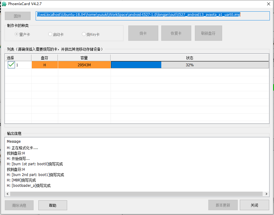

刷写到 eMMC 启动
由于安卓镜像打包的特殊性,首先需要去下载原厂的TF卡烧卡芯软件
前往 https://www.aw-ol.com/downloads?cat=5
找到 PhoenixCardv4.2.7.7z 并点击下载。下载需要全志在线账号,可以注册一个。
下载后解压文件
找到可执行文件运行
点击固件按钮
选择需要烧录的固件
选择量产卡
点击 恢复卡 格式化卡
点击 烧卡,开始烧卡
烧卡中
烧卡完成,将TF卡插入开发板上电,TF卡加载烧录程序进行eMMC的刷写,开发板串口LOG如下

[104.757]successed in download part dtbo_a
[104.761]begin to download part Reserve0
partdata hi 0x0
partdata lo 0x1000000
sparse: bad magic
[105.677]successed in writting part Reserve0
origin_verify value = 0, active_verify value = 0
[105.774]successed in verify part Reserve0
[105.778]successed in download part Reserve0
[105.785]successed in downloading part
uboot size = 0x14c000
storage type = 2
sunxi_sprite_deal_uboot ok
[105.888]successed in downloading uboot
[105.896][mmc]: write mmc 2 info ok
storage type = 2
[105.910]successed in downloading boot0
CARD OK
[105.914]sprite success
>>>[144]{"step":"firmware","PN":"xxx","SN":"xxx","CN":"xxx","result":{"module":"image","progress":"20", "state":"0","message":"write image succuess"}}
sprite_next_work=3
next work 3
SUNXI_UPDATE_NEXT_ACTION_SHUTDOWN
[108.936][mmc]: mmc exit start
[108.954][mmc]: mmc 2 exit ok
