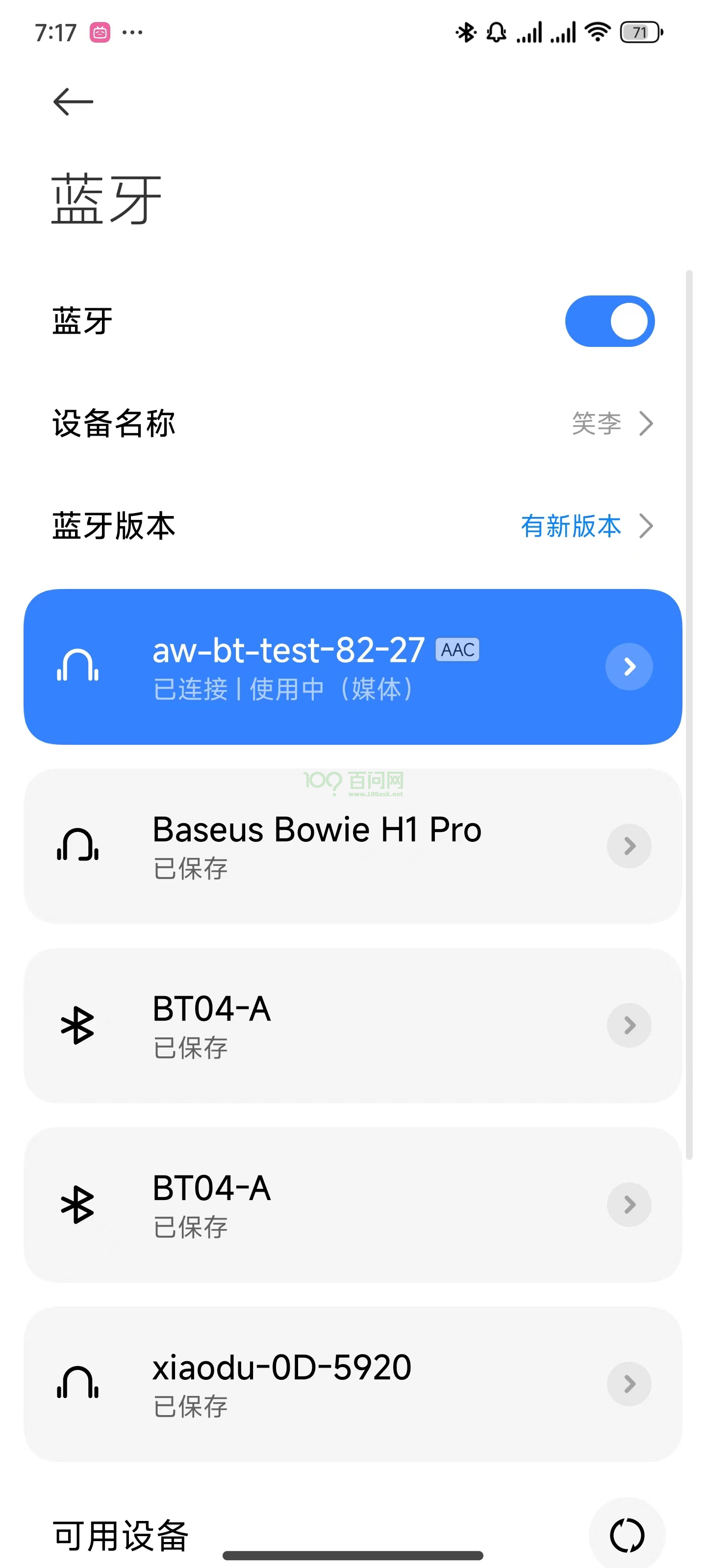

成功启动蓝牙,这样就可以打开手机配对蓝牙aw-bt-test-82-27了。
配对成功后,串口终端打印信息如下:
[BT]:1970-01-01 09:56:01:896: BTMG[bt_test_agent_authorize_service_cb:192]:  AGENT: 04:10:6B:F9:43:23 Authorize Service 0000110d-0000-1000-8000-00805f9b34fb
1970-01-01 09:56:02:183: BTMG[supervise_pcm_worker_start:131]:  transport A2DP:AAC
1970-01-01 09:56:02:184: BTMG[a2dp_pcm_worker_routine:115]:  codec:AAC, sampling:44100, channels:2, format_size:2
1970-01-01 09:56:02:191: BTMG[a2dp_pcm_worker_routine:149]:  Starting PCM loop
1970-01-01 09:56:02:545: BTMG[bt_test_agent_authorize_service_cb:192]:  AGENT: 04:10:6B:F9:43:23 Authorize Service 0000110e-0000-1000-8000-00805f9b34fb
1970-01-01 09:56:02:590: BTMG[bt_test_a2dp_sink_connection_state_cb:205]:  A2DP sink connected with device: 04:10:6B:F9:43:23
1970-01-01 09:56:02:626: BTMG[bluez_signal_mediatransport_properties_changed:506]:  Volume is :59
1970-01-01 09:56:02:626: BTMG[bt_test_avrcp_audio_volume_cb:287]:  AVRCP audio volume:04:10:6B:F9:43:23 : 59
1970-01-01 09:56:03:058: BTMG[bt_test_avrcp_play_state_cb:260]:  BT palying music paused with device: 04:10:6B:F9:43:23
1970-01-01 09:56:03:061: BTMG[bt_test_avrcp_track_changed_cb:276]:  BT playing music title: Not Provided
1970-01-01 09:56:03:061: BTMG[bt_test_avrcp_track_changed_cb:277]:  BT playing music artist:
1970-01-01 09:56:03:061: BTMG[bt_test_avrcp_track_changed_cb:278]:  BT playing music album:
[BT]:
