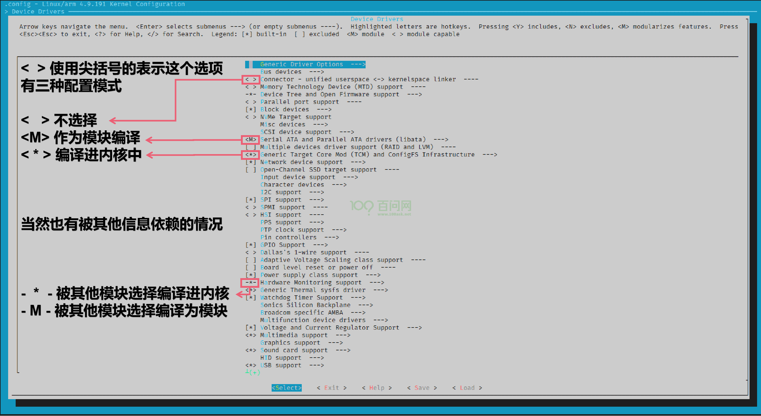

Kconfig 配置方法
如果你需要修改内核配置项,可以在TinaSDK源码目录下执行 make kernel_menuconfig命令来进入到 内核的菜单选项界面。
对于menuconfig是一种图形化配置工具,这里以 kernel menuconfig 作为例子,讲解如何使用 Kconfig 基础配置方法。
首先我们进入 kernel menuconfig
ubuntu@ubuntu1804:~/tina-d1-h$ make kernel_menuconfig
===This's tina environment.===
special target, skip mboot,marisc
export MAKEFLAGS= ;make V=ss -C target/allwinner menuconfig
make[1]: Entering directory '/home/ubuntu/tina-d1-h/target/allwinner'
make[2]: Entering directory '/home/ubuntu/tina-d1-h/target/allwinner/t113-100ask'
rm -f /home/ubuntu/tina-d1-h/out/t113-100ask/compile_dir/target/linux-t113-100ask/linux-5.4.61/.config.prev
rm -f /home/ubuntu/tina-d1-h/out/t113-100ask/compile_dir/target/linux-t113-100ask/linux-5.4.61/.configured
/home/ubuntu/tina-d1-h/scripts/kconfig.pl + /home/ubuntu/tina-d1-h/target/allwinner/generic/config-5.4 /home/ubuntu/tina-d1-h/device/config/chips/t113/configs/100ask/linux/config-5.4 > /home/ubuntu/tina-d1-h/out/t113-100ask/compile_dir/target/linux-t113-100ask/linux-5.4.61/.config
export MAKEFLAGS= ;make -C /home/ubuntu/tina-d1-h/out/t113-100ask/compile_dir/target/linux-t113-100ask/linux-5.4.61 -C /home/ubuntu/tina-d1-h/out/t113-100ask/compile_dir/target/linux-t113-100ask/linux-5.4.61 HOSTCFLAGS="-O2 -I/home/ubuntu/tina-d1-h/out/host/include -I/home/ubuntu/tina-d1-h/out/host/usr/include -Wall -Wmissing-prototypes -Wstrict-prototypes" CROSS_COMPILE="arm-openwrt-linux-muslgnueabi-" ARCH="arm" KBUILD_HAVE_NLS=no KBUILD_BUILD_USER="" KBUILD_BUILD_HOST="" CONFIG_SHELL="bash" V='' CC="arm-openwrt-linux-muslgnueabi-gcc" menuconfig
make[3]: Entering directory '/home/ubuntu/tina-d1-h/lichee/linux-5.4'
--define-variable argument does not have a value for the variable
scripts/kconfig/mconf Kconfig
configuration written to .config
*** End of the configuration.
*** Execute 'make' to start the build or try 'make help'.
make[3]: Leaving directory '/home/ubuntu/tina-d1-h/lichee/linux-5.4'
make[2]: Leaving directory '/home/ubuntu/tina-d1-h/target/allwinner/t113-100ask'
make[1]: Leaving directory '/home/ubuntu/tina-d1-h/target/allwinner'
#### make completed successfully (6 seconds) ####

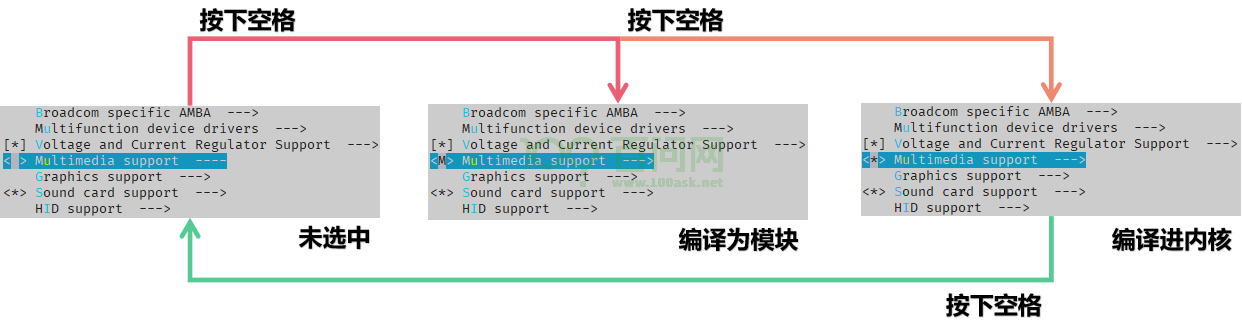

也可以使用 Y M N 键 来修改选项:
在 Kconfig 的界面中按 / 键,进入搜索页面。
