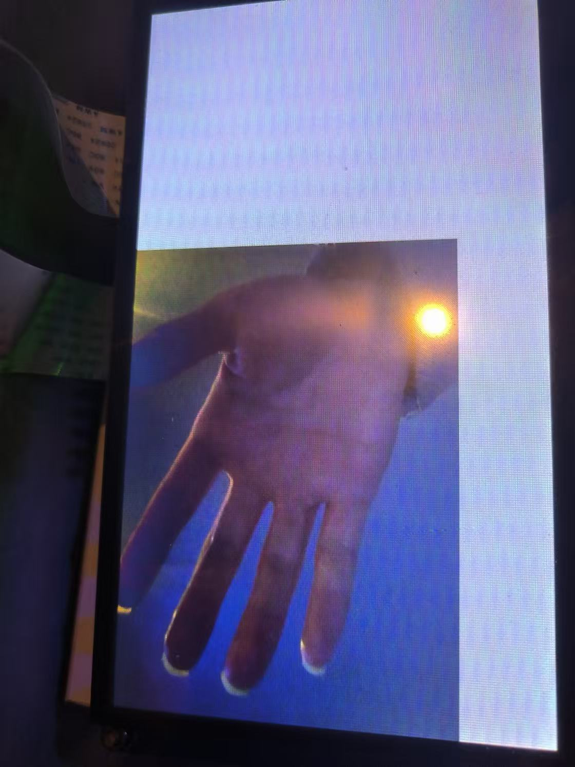

整体思路
将UVC 相机插入装有linux系统的个人电脑;
从UVC 相机获取MJPEG数据并发送;
通过 T113s3板载的aic8800网卡接收并显示在屏幕上面。

outputDataTpe = JpegDecodeOutputDataNV12;
} else if(strcmp(argv[3], "yu12") == 0){
outputDataTpe = JpegDecodeOutputDataYU12;
} else if(strcmp(argv[3], "yv12") == 0){
outputDataTpe = JpegDecodeOutputDataYV12;
} else if(strcmp(argv[3], "rgb565") == 0){
outputDataTpe = JpegDecodeOutputDataRGB565;
} else {
printf("the %s is not support,use the default outputDataTpe:nv21\n", argv[3]);
outputDataTpe = JpegDecodeOutputDataNV21;
linuxfbinit( );
while (stop_server == 0)
int len = recvfrom(sockfd, (char *)socbuffer, UDP_BUFFER_SIZE, MSG_WAITALL,
(struct sockaddr *)&client_addr, &addr_len);
if (len < 0)
perror("UDP recvfrom failed");
printf("Received message of length: %d bytes\n", len);
// 确保数据长度符合要求
if (len <= 0 || len > UDP_BUFFER_SIZE)
printf("Invalid data length\n");
continue;
// 清空并重新分配帧缓冲区
free(frame_data);
frame_data = (char *)malloc(len);
if (frame_data == NULL)
perror("Memory allocation failed");
frame_data_size = 0;
continue;
// 将接收到的数据复制到帧缓冲区
memcpy(frame_data, socbuffer, len);
frame_data_size = len;
printf("New frame received, processing...\n");
char* srcBuf;
int srcBufLen = 0;
srcBuf = readSrcData(argv[1], &srcBufLen);
// 调用解码函数,确保解码后的内存管理正确
jpegdecodePacktest(frame_data, frame_data_size, scaleRatio, outputDataTpe, rgb888Data, rgba8888Data);
// 确保解码后不重复释放内存
// 如果解码过程中已分配了内存并释放,请确保在此不再调用 free(frame_data)
frame_data = NULL;
munmap(fb_mem,var.xres*var.yres*4); //映射后的地址,通过mmap返回的值
close(framebufferfd); //关闭fb0设备文件
close(sockfd);
printf("UDP server thread stopped.\n");
printf("\n");
printf("*************************************************************************\n");
printf("* Quit the program, goodbye!\n");
printf("********************************************************************\n");
printf("\n");
接收截图如下:
