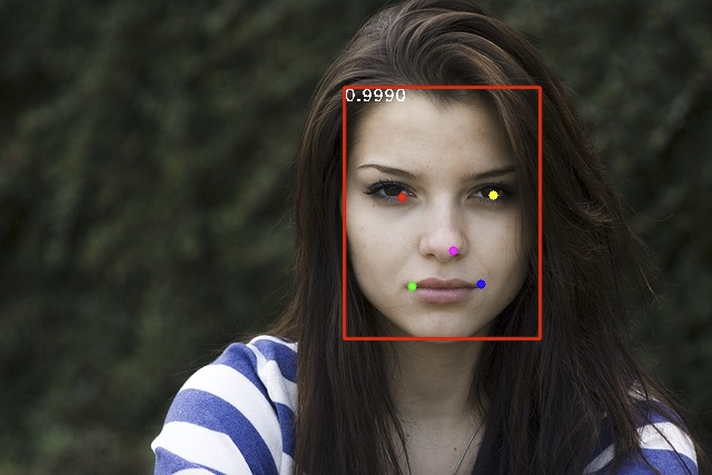

运行效果如下:
(rknn-toolkit2) baiwen@dshanpi-a1:~/Projects/rknn_model_zoo/examples/RetinaFace/python$ python3 RetinaFace.py --model_path ../model/RetinaFace.rknn --target rk3576
I rknn-toolkit2 version: 2.3.2
done
--> Init runtime environment
I target set by user is: rk3576
done
--> Running model
W inference: The 'data_format' is not set, and its default value is 'nhwc'!
image_size: (640, 640) num_priors= 16800
face @ (309 78 485 304) 0.999023
save image in ./result.jpg
可以看到运行完成后会保存结果图像result.jpg在当前目录下。

# 5. 后处理
boxes = box_decode(loc.squeeze(0), priors)
scale = np.array([model_width, model_height,
model_width, model_height])
boxes = boxes * scale
boxes[..., 0::2] = np.clip((boxes[..., 0::2] - offset_x) / aspect_ratio, 0, img_width)
boxes[..., 1::2] = np.clip((boxes[..., 1::2] - offset_y) / aspect_ratio, 0, img_height)
scores = conf.squeeze(0)[:, 1]
landmarks = decode_landm(landmarks.squeeze(0), priors)
scale_lm = np.array([model_width, model_height] * 5)
landmarks = landmarks * scale_lm
landmarks[..., 0::2] = np.clip((landmarks[..., 0::2] - offset_x) / aspect_ratio, 0, img_width)
landmarks[..., 1::2] = np.clip((landmarks[..., 1::2] - offset_y) / aspect_ratio, 0, img_height)
inds = np.where(scores > 0.4)[0] # 阈值可调
dets = np.hstack((boxes[inds], scores[inds, np.newaxis])).astype(np.float32)
keep = nms(dets, 0.5)
dets = dets[keep]
landmarks = landmarks[inds][keep]
# 6. 画框画点
for det in dets:
x1, y1, x2, y2 = det[:4].astype(int)
score = det[4]
cv2.rectangle(frame, (x1, y1), (x2, y2), (0, 0, 255), 2)
cv2.putText(frame, f'{score:.2f}', (x1, y1 - 5),
cv2.FONT_HERSHEY_SIMPLEX, 0.5, (0, 255, 0), 1)
for lm in landmarks:
for k in range(5):
cv2.circle(frame, (int(lm[2*k]), int(lm[2*k+1])), 2, (0, 255, 255), -1)
# 7. 实时显示
cv2.imshow('RetinaFace Real-time', frame)
break
# 8. 清理
cap.release()
cv2.destroyAllWindows()
rknn.release()
2.运行视频流推理
python3 RetinaFace_video.py --model_path ../model/RetinaFace.rknn --target rk3576
