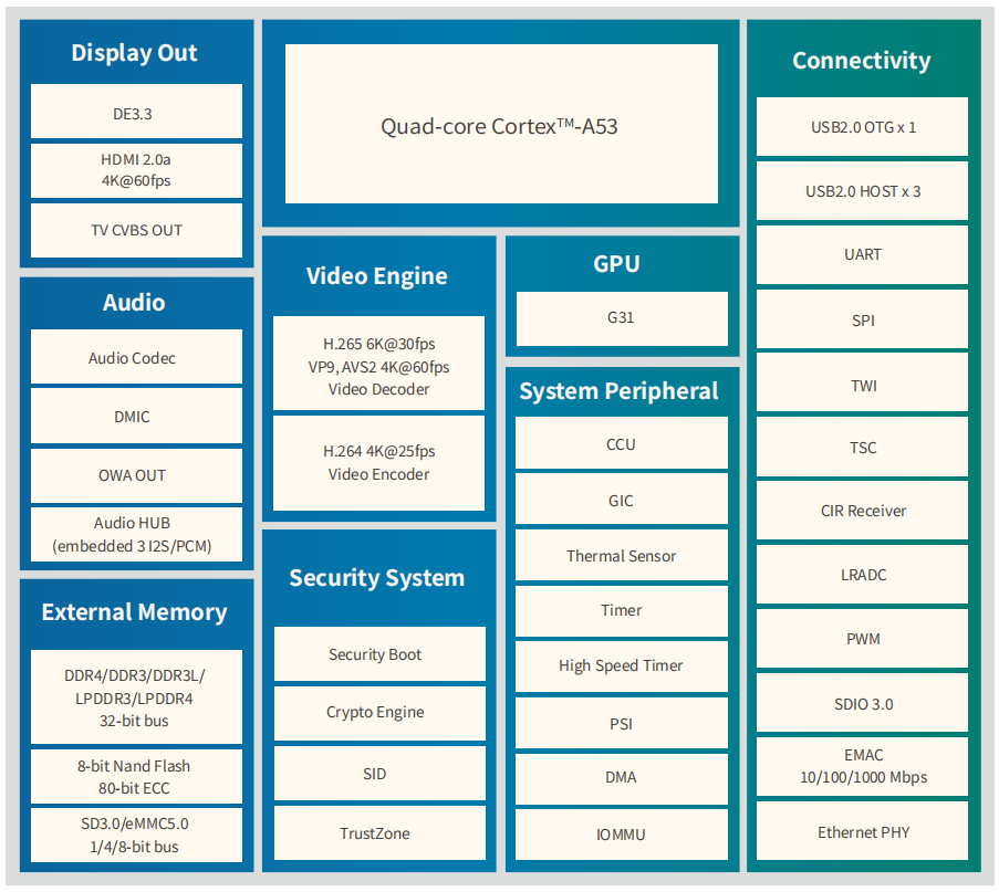

处理器参数
Avaota C1 使用的是 Allwinner H618 处理器,其框图如下:
- Features a quad-core ARM Cortex-A53 processor with 64-bit architecture
 - Equipped with a high-performance multi-core G31 GPU that supports OpenGL ES 3.2 and Vulkan 1.1
 - Capable of decoding full formats H.265/VP9/AVS2 at 4K@60fps
 - Offers a maximum decoding performance of 6K@30fps for H.265-encoded content
 - Supports low-latency H.264 video encoding at 4K@25fps
 - Compatible with HDR10 and HLG for enhanced visual experiences
 - Incorporates the SmartColor 3.3 picture enhancement engine for improved image quality
