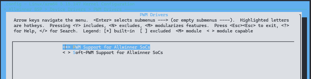

驱动配置
驱动位于
PWM Drivers ->
	<*> PWM Support for Allwinner SoCs
	< > Soft-PWM Support for Allwinner SoCs
