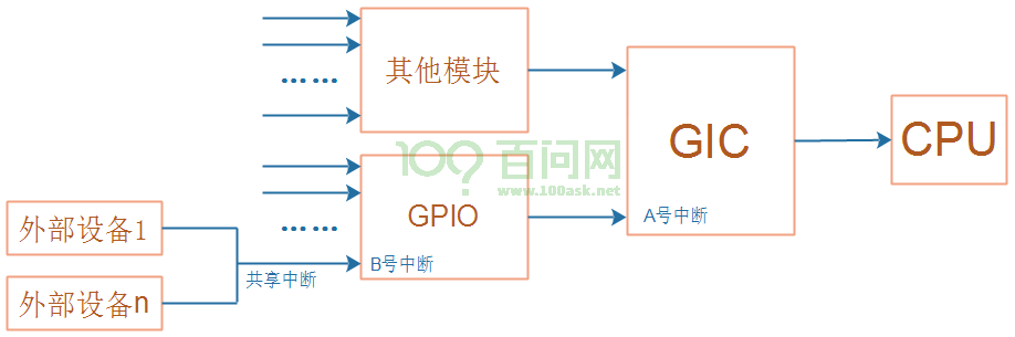

1. 回顾中断的发生、处理过程​
  • 中断发生的硬件过程
image-20210626114958795

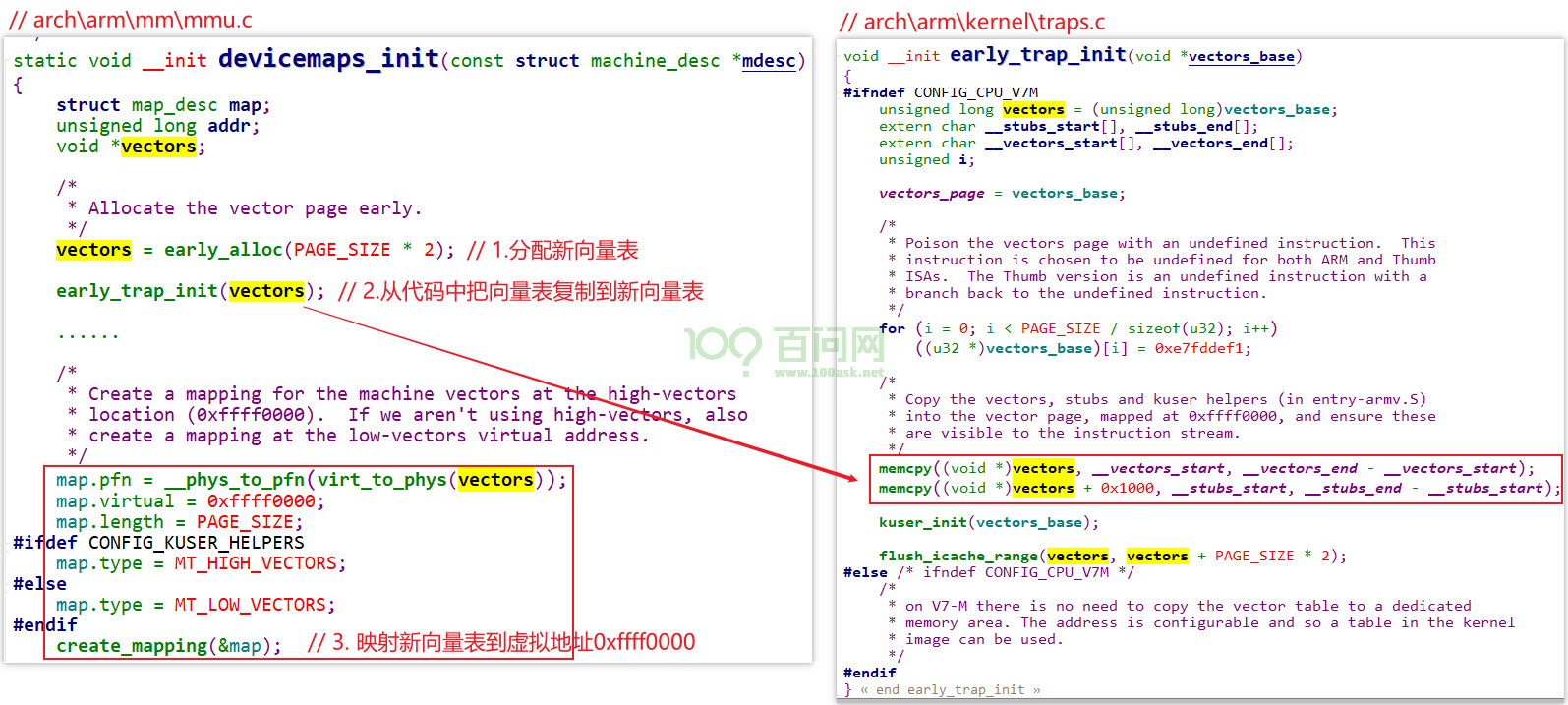

  • 复制向量表
start_kernel // init\main.c
setup_arch(&command_line); // arch\arm\kernel\setup.c
paging_init(mdesc); // arch\arm\mm\mmu.c
devicemaps_init(mdesc); // arch\arm\mm\mmu.c
vectors = early_alloc(PAGE_SIZE * 2); // 1.分配新向量表
early_trap_init(vectors); // 2.从代码把向量表复制到新向量表
// 3. 映射新向量表到虚拟地址0xffff0000
* Create a mapping for the machine vectors at the high-vectors
* location (0xffff0000). If we aren't using high-vectors, also
* create a mapping at the low-vectors virtual address.
map.pfn = __phys_to_pfn(virt_to_phys(vectors));
map.virtual = 0xffff0000;
map.length = PAGE_SIZE;
#ifdef CONFIG_KUSER_HELPERS
map.type = MT_HIGH_VECTORS;
#else
map.type = MT_LOW_VECTORS;
create_mapping(&map);
image-20210626120817244

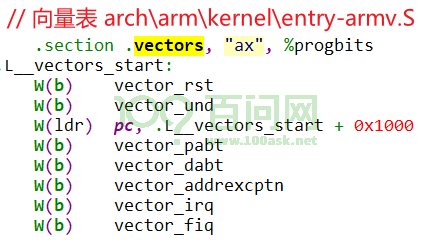

2.2 向量表在哪​
上面代码中可以看到代码中向量表位于__vectors_start,它在arch/arm/kernel/vmlinux.lds中定义:
__vectors_start = .;
.vectors 0xffff0000 : AT(__vectors_start) {
*(.vectors)
. = __vectors_start + SIZEOF(.vectors);
__vectors_end = .;
__stubs_start = .;
.stubs ADDR(.vectors) + 0x1000 : AT(__stubs_start) {
*(.stubs)
在代码里搜.vectors,可以找到向量表:
image-20210626124004537

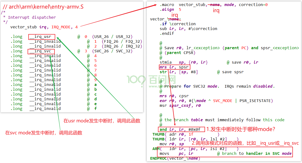

3. 中断向量​
发生中断时,CPU跳到向量表去执行b vector_irq。
vector_irq函数使用宏来定义:
image-20210626125245059

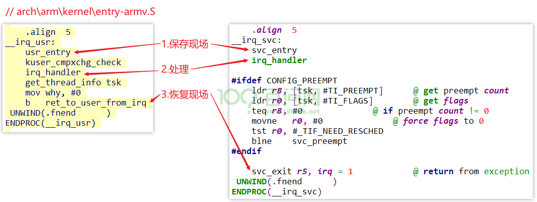

4. 处理流程​
image-20210626130003359

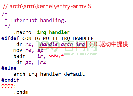

5. 处理函数​
image-20210626130412855
