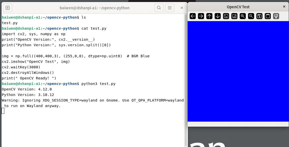

1.2 测试
新建文件test.py,将下面的内容填入:
import cv2, sys, numpy as np
print("OpenCV Version:", cv2.__version__)
print("Python Version:", sys.version.split()[0])
img = np.full((400,400,3), (255,0,0), dtype=np.uint8) # BGR Blue
cv2.imshow("OpenCV Test", img)
cv2.waitKey(3000)
cv2.destroyAllWindows()
print("OpenCV Ready!")
填写完代码后执行:
python3 test.py
运行效果如下:

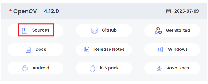

3.本地编译
1.下载OpenCV包(以4.12为例)
wget https://github.com/opencv/opencv/archive/refs/tags/4.12.0.zip
如果无法下载可访问OpenCV官网资源下载:https://opencv.org/releases/

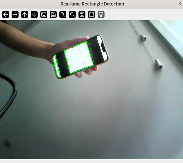

4.4 矩形检测
#!/usr/bin/env python3
import cv2
import numpy as np
# ------------ camera setup ------------
cap = cv2.VideoCapture(0, cv2.CAP_V4L2) # change index if necessary
if not cap.isOpened():
raise RuntimeError("Cannot open camera")
cap.set(cv2.CAP_PROP_FRAME_WIDTH, 640)
cap.set(cv2.CAP_PROP_FRAME_HEIGHT, 480)
# ------------ parameters ------------
# Canny thresholds
CANNY_LOW = 50
CANNY_HIGH = 150
# contour approximation accuracy (epsilon = arcLength * ratio)
APPROX_RATIO = 0.02
# min area filter (ignore tiny noise)
MIN_AREA = 500
ret, frame = cap.read()
if not ret:
print("Frame read failed")
break
# ---------- pre-processing ----------
gray = cv2.cvtColor(frame, cv2.COLOR_BGR2GRAY)
blur = cv2.GaussianBlur(gray, (5, 5), 0)
edges = cv2.Canny(blur, CANNY_LOW, CANNY_HIGH)
# ---------- find contours ----------
contours, _ = cv2.findContours(edges, cv2.RETR_EXTERNAL,
cv2.CHAIN_APPROX_SIMPLE)
# ---------- loop over contours ----------
for cnt in contours:
area = cv2.contourArea(cnt)
if area < MIN_AREA:
continue
# polygonal approximation
epsilon = APPROX_RATIO * cv2.arcLength(cnt, True)
approx = cv2.approxPolyDP(cnt, epsilon, True)
# we need 4 vertices => rectangle
if len(approx) == 4:
cv2.drawContours(frame, [approx], -1, (0, 255, 0), 2)
# ---------- display ----------
cv2.imshow("Real-time Rectangle Detection", frame)
# quit on 'q' or ESC
key = cv2.waitKey(1) & 0xFF
if key in (27, ord('q')):
break
# ---------- cleanup ----------
cap.release()
运行效果:

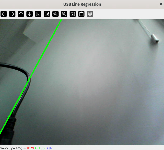

4.5 快速线性回归
import cv2
import numpy as np
# ---------- camera ----------
# ---------- parameters ----------
CANNY_LOW = 50
CANNY_HIGH = 150
HOUGH_RHO = 1
HOUGH_THETA = np.pi / 180
HOUGH_TH = 100 # Hough threshold
MIN_LINE = 50 # minLineLength
MAX_GAP = 10 # maxLineGap
DRAW_COLOR = (0, 255, 0)
DRAW_THICK = 3
def draw_regression(frame, points):
"""Fit y = kx + b with NumPy polyfit and draw the line."""
if points.shape[0] < 2:
return
x, y = points[:, 0], points[:, 1]
k, b = np.polyfit(x, y, 1) # 1-degree polynomial = linear
h, w = frame.shape[:2]
x0, x1 = 0, w
y0, y1 = int(k * x0 + b), int(k * x1 + b)
cv2.line(frame, (x0, y0), (x1, y1), DRAW_COLOR, DRAW_THICK)
if not ret:
break
# Hough line segments
lines = cv2.HoughLinesP(edges,
HOUGH_RHO,
HOUGH_THETA,
HOUGH_TH,
minLineLength=MIN_LINE,
maxLineGap=MAX_GAP)
# collect endpoints
pts = []
if lines is not None:
for x1, y1, x2, y2 in lines[:, 0]:
pts.extend([[x1, y1], [x2, y2]])
if pts:
pts = np.array(pts, dtype=np.float32)
draw_regression(frame, pts)
cv2.imshow("USB Line Regression", frame)
if cv2.waitKey(1) & 0xFF in (27, ord('q')):
break
cap.release()
运行效果:

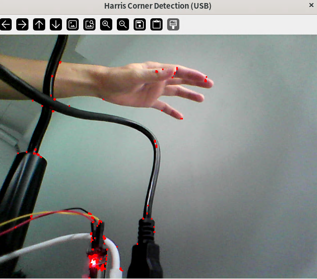

4.6 角点检测
import cv2
import numpy as np
# ---------- open camera ----------
cap = cv2.VideoCapture(0, cv2.CAP_V4L2) # change index if needed
# optional resolution
# ---------- Harris parameters ----------
HARRIS_BLOCK_SIZE = 2 # neighbourhood size
HARRIS_KSIZE = 3 # Sobel aperture
HARRIS_K = 0.04 # Harris detector free parameter
THRESH_RATIO = 0.01 # corner response threshold ratio
if not ret:
break
# ---------- Harris corner detection ----------
gray = np.float32(gray)
dst = cv2.cornerHarris(gray,
blockSize=HARRIS_BLOCK_SIZE,
ksize=HARRIS_KSIZE,
k=HARRIS_K)
# dilate corners for better visibility
dst = cv2.dilate(dst, None)
# threshold corner response
frame[dst > THRESH_RATIO * dst.max()] = [0, 0, 255]
# ---------- show ----------
cv2.imshow("Harris Corner Detection (USB)", frame)
break
cap.release()
运行效果:

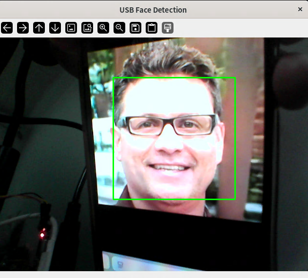

4.7 人脸检测
import cv2
# 0. 打开摄像头
# 1. 加载 Haar 人脸模型(已随 OpenCV 安装)
face_cascade = cv2.CascadeClassifier(cv2.data.haarcascades +
'haarcascade_frontalface_default.xml')
if not ret:
break
# 2. 灰度化 + 检测
faces = face_cascade.detectMultiScale(gray,
scaleFactor=1.1,
minNeighbors=5,
minSize=(50, 50))
# 3. 画框
for (x, y, w, h) in faces:
cv2.rectangle(frame, (x, y), (x + w, y + h),
(0, 255, 0), 2)
# 4. 显示
cv2.imshow("USB Face Detection", frame)
break
cap.release()
运行效果:
