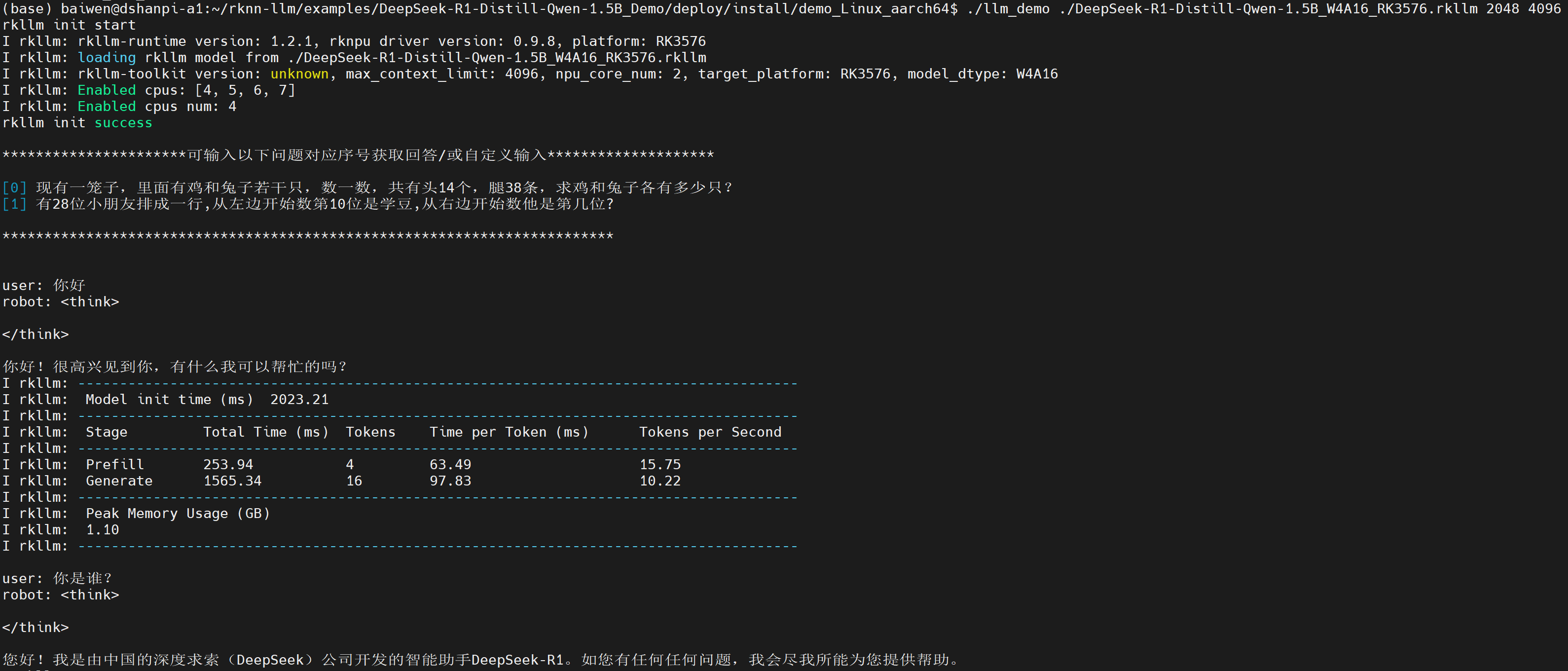

2.1 DeepSeek-R1 1.5B
1.导入依赖和环境变量
export LD_LIBRARY_PATH=./lib
export RKLLM_LOG_LEVEL=1
2.执行程序
./llm_demo ./DeepSeek-R1-Distill-Qwen-1.5B_W4A16_RK3576.rkllm 2048 4096
image-20250822105053016
如果想退出可输入Ctrl+C
