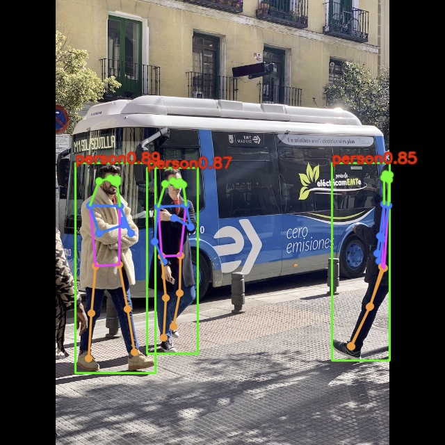

3.模型推理
执行推理测试代码:
python3 yolov8_pose.py --model_path ../model/yolov8_pose.rknn --target rk3576
运行效果如下:
(rknn-toolkit2) baiwen@dshanpi-a1:~/Projects/rknn_model_zoo/examples/yolov8_pose/python$ python3 yolov8_pose.py --model_path ../model/yolov8_pose.rknn --target rk3576
I rknn-toolkit2 version: 2.3.2
done
--> Init runtime environment
I target set by user is: rk3576
done
--> Running model
W inference: The 'data_format' is not set, and its default value is 'nhwc'!
save image in ./result.jpg
结果图像。

0.7, (0, 0, 255), 2, cv2.LINE_AA)
kpts = box.keypoint.reshape(-1, 3)
kpts[..., 0] = (kpts[..., 0] - off_x) / ar
kpts[..., 1] = (kpts[..., 1] - off_y) / ar
# 画点
for k, (x, y, conf) in enumerate(kpts):
if x != 0 and y != 0:
cv2.circle(frame, (int(x), int(y)), 5,
[int(c) for c in kpt_color[k]], -1)
# 画骨架
for k, sk in enumerate(skeleton):
pos1 = (int(kpts[sk[0]-1, 0]), int(kpts[sk[0]-1, 1]))
pos2 = (int(kpts[sk[1]-1, 0]), int(kpts[sk[1]-1, 1]))
if 0 in pos1 + pos2:
continue
cv2.line(frame, pos1, pos2,
[int(c) for c in limb_color[k]], 2, cv2.LINE_AA)
# 7. 实时显示
cv2.imshow('YOLOv8-Pose', frame)
break
cap.release()
cv2.destroyAllWindows()
rknn.release()
2.运行视频流推理
python3 yolov8_pose_video.py --model_path ../model/yolov8_pose.rknn --target rk3576
