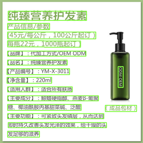

3.3 文字检测与识别
执行推理测试代码:
python3 ppocr_system.py --det_model_path ../../PPOCR-Det/model/ppocrv4_det.rknn --rec_model_path ../../PPOCR-Rec/model/ppocrv4_rec.rknn --target rk3576
运行效果如下:
(rknn-toolkit2) baiwen@dshanpi-a1:~/Projects/rknn_model_zoo/examples/PPOCR/PPOCR-System/python$ python3 ppocr_system.py --det_model_path ../../PPOCR-Det/model/ppocrv4_det.rknn --rec_model_path ../../PPOCR-Rec/model/ppocrv4_rec.rknn --target rk3576
I rknn-toolkit2 version: 2.3.2
--> Init runtime environment
I target set by user is: rk3576
done
Model-../../PPOCR-Det/model/ppocrv4_det.rknn is rknn model, starting val
done
Model-../../PPOCR-Rec/model/ppocrv4_rec.rknn is rknn model, starting val
W inference: The 'data_format' is not set, and its default value is 'nhwc'!
[[('纯臻营养护发素', 0.7113560438156128)], [('产品信息/参数', 0.70751953125)], [('(45元/每公斤,100公斤起订)', 0.6903291344642639)], [('每瓶22元,1000瓶起订)', 0.7074149250984192)], [('【品牌】:代加工方式/OEMODM', 0.7088407874107361)], [('【品名】:纯臻营养护发素', 0.7105305790901184)], [('【产品编号】:YM-X-3011', 0.707122802734375)], [('ODM OEM', 0.6842215657234192)], [('【净含量】:220ml', 0.7087180614471436)], [('【适用人群】:适合所有肤质', 0.7098482847213745)], [('【主要成分】:鲸蜡硬脂醇、燕麦β-葡聚', 0.6930252909660339)], [('糖、椰油酰胺丙基甜菜碱、泛酸', 0.6709246039390564)], [('(成品包材)', 0.7081705927848816)], [('【主要功能】:可紧致头发磷层,从而达到', 0.7100637555122375)], [('即时持久改善头发光泽的效果,给干燥的头', 0.7112202048301697)], [('发足够的滋养', 0.7110188603401184)]]

boxes, rec_res = system_model.run(img)
vis = draw_ocr_box_txt(img, boxes, rec_res)
cv2.imshow("PPOCR-System", vis)
