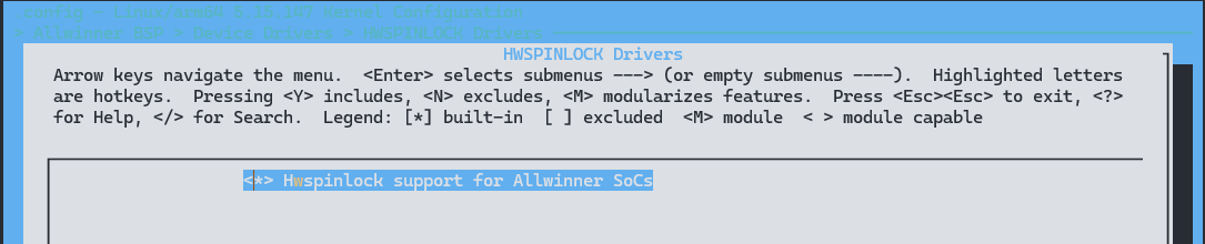

模块配置
驱动配置
HWSPINLOCK Drivers ->
<*> Hwspinlock support for Allwinner SoCs
