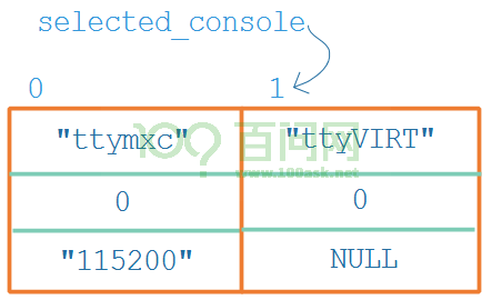

这是用来处理u-boot通过设备树传给内核的cmdline参数,比如cmdline中有如下代码:
console=ttymxc0,115200 console=ttyVIRT0
对于这两个"console=xxx"就会调用console_setup函数两次,构造得到2个数组项:
struct console_cmdline
char name[16]; /* Name of the driver */
int index; /* Minor dev. to use */
char *options; /* Options for the driver */
#ifdef CONFIG_A11Y_BRAILLE_CONSOLE
char *brl_options; /* Options for braille driver */
static struct console_cmdline console_cmdline[MAX_CMDLINECONSOLES];
在cmdline中,最后的"console=xxx"就是"selected_console"(被选中的console,对应/dev/console):
image-20210816075055595
