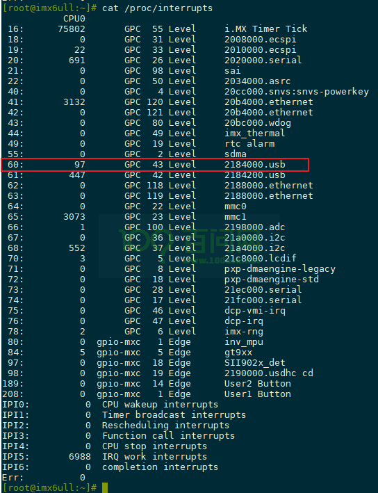

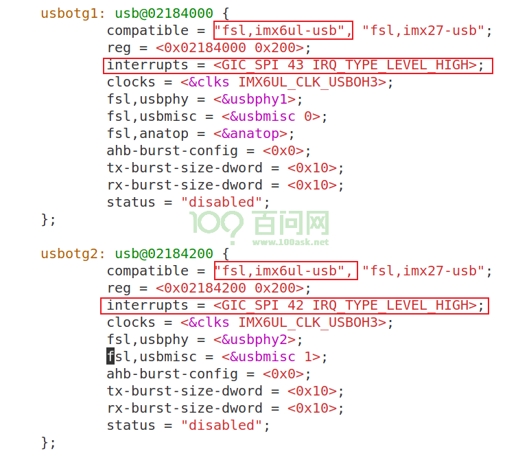

中断:
image-20221118102514064

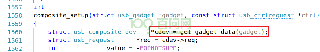

// composite_driver_template.setup
composite_setup

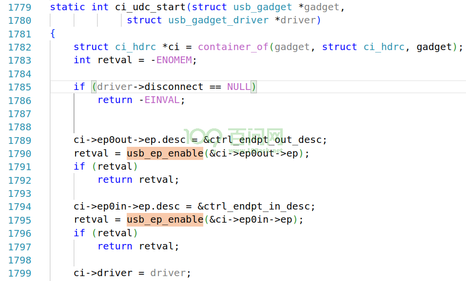

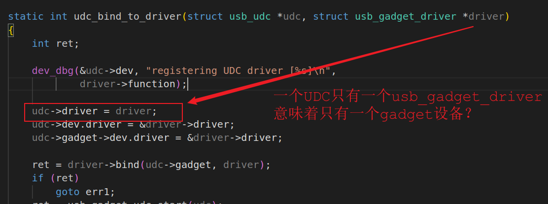

1.2.4 EP什么时候使能​
static int udc_bind_to_driver(struct usb_udc *udc, struct usb_gadget_driver *driver)
int ret;
dev_dbg(&udc->dev, "registering UDC driver [%s]\n",
driver->function);
udc->driver = driver;
udc->dev.driver = &driver->driver;
udc->gadget->dev.driver = &driver->driver;
ret = driver->bind(udc->gadget, driver);
if (ret)
goto err1;
ret = usb_gadget_udc_start(udc);
return udc->gadget->ops->udc_start(udc->gadget, udc->driver);
ci_udc_start
