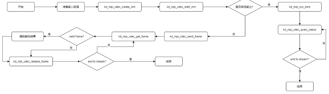

1.1 解码典型应用举例​
image-20241106175627249

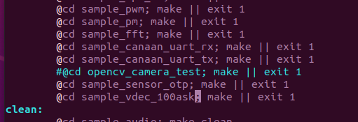

修改k230_sdk/src/big/mpp/userapps/sample目录下的Makefile文件,新增sample_vdec_100ask工程的编译规则
@cd sample_vdec_100ask; make || exit 1
image-20241022150739044
@cd sample_vdec_100ask; make clean
image-20241022150817309

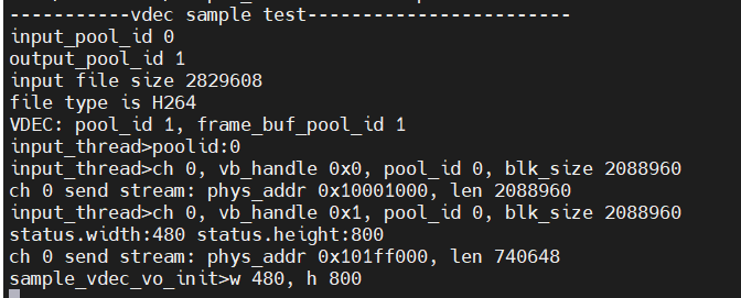

./sample_vdec_100ask.elf -i output-480-800.h264 // output-480-800.h265 output-480-800.jpeg

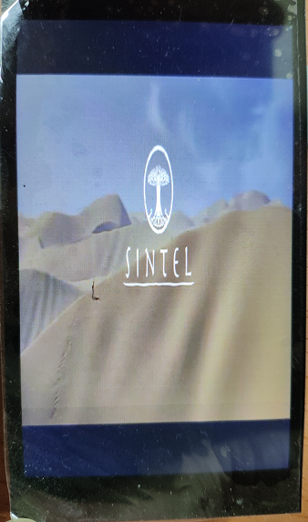

执行过程效果如下所示:
2.1 对输入文件进行解码播放:
image-20241022151246698
image-20241022151558122

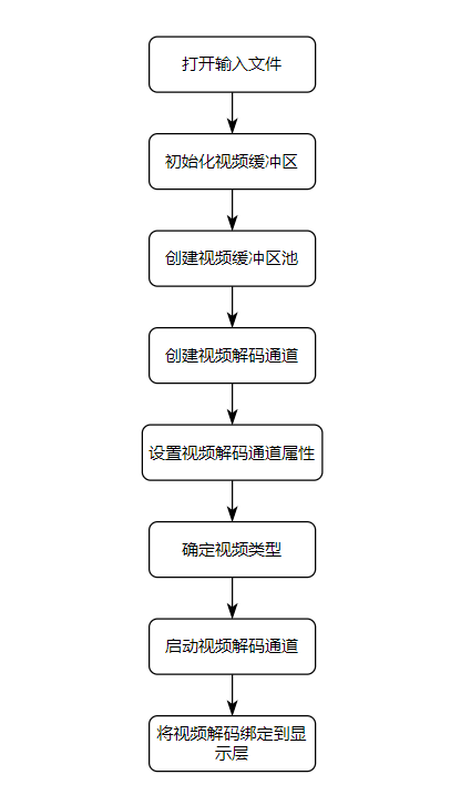

代码流程图如下所示:
image-20241022155913648
2.3.1 打开输入文件​
FILE *input_file = fopen(argv[2], "rb");
2.3.2 初始化视频缓冲区​
memset(&config, 0, sizeof(config));
config.max_pool_cnt = 2;
// 设置视频缓冲区配置
ret = kd_mpi_vb_set_config(&config);
2.3.3 创建视频缓冲区池​
k_vb_pool_config pool_config;
memset(&pool_config, 0, sizeof(pool_config));
pool_config.blk_cnt = INPUT_BUF_CNT; // 设置输入缓冲区池的块数量
pool_config.blk_size = STREAM_BUF_SIZE; // 设置输入缓冲区池的块大小
pool_config.mode = VB_REMAP_MODE_NOCACHE; // 设置输入缓冲区池的映射模式
g_vdec_conf[ch].input_pool_id = kd_mpi_vb_create_pool(&pool_config); // 创建输入缓冲区池
vdec_debug("input_pool_id %d\n", g_vdec_conf[ch].input_pool_id);
pool_config.blk_cnt = OUTPUT_BUF_CNT; // 设置输出缓冲区池的块数量
pool_config.blk_size = FRAME_BUF_SIZE; // 设置输出缓冲区池的块大小
pool_config.mode = VB_REMAP_MODE_NOCACHE; // 设置输出缓冲区池的映射模式
g_vdec_conf[ch].output_pool_id = kd_mpi_vb_create_pool(&pool_config); // 创建输出缓冲区池
2.3.4 创建视频解码通道​
ret = kd_mpi_vdec_create_chn(ch, &attr);
2.3.5 设置视频解码通道属性​
attr.pic_width = MAX_WIDTH; // 设置图片最大宽度
attr.pic_height = MAX_HEIGHT; // 设置图片最大高度
attr.frame_buf_cnt = OUTPUT_BUF_CNT; // 设置帧缓冲区数量
attr.frame_buf_size = FRAME_BUF_SIZE; // 设置帧缓冲区大小
attr.stream_buf_size = STREAM_BUF_SIZE; // 设置流缓冲区大小
2.3.6 根据文件扩展名确定视频类型​
char *ptr = strrchr(argv[2], '.');
if (ptr!= NULL) {
if (strcmp(ptr, ".h264") == 0 || strcmp(ptr, ".264") == 0) {
type = K_PT_H264;
vdec_debug("file type is H264\n");
} else if (strcmp(ptr, ".jpeg") == 0 || strcmp(ptr, ".mjpeg") == 0 || strcmp(ptr, ".jpg") == 0) {
type = K_PT_JPEG;
vdec_debug("file type is JPEG\n");
} else if (strcmp(ptr, ".h265") == 0 || strcmp(ptr, ".hevc") == 0 || strcmp(ptr, ".265") == 0) {
type = K_PT_H265;
vdec_debug("file type is H265\n");
} else {
vdec_debug("Error input type\n");
2.3.7 启动视频解码通道​
ret = kd_mpi_vdec_start_chn(ch);
2.3.8 将视频解码绑定到显示层​
sample_vdec_bind_vo(BIND_VO_LAYER);
