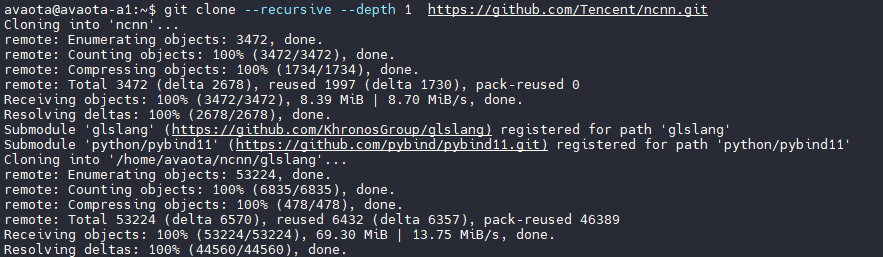

ncnn 源码下载​
git clone --recursive --depth 1 https://github.com/Tencent/ncnn.git
image-20240616203647818

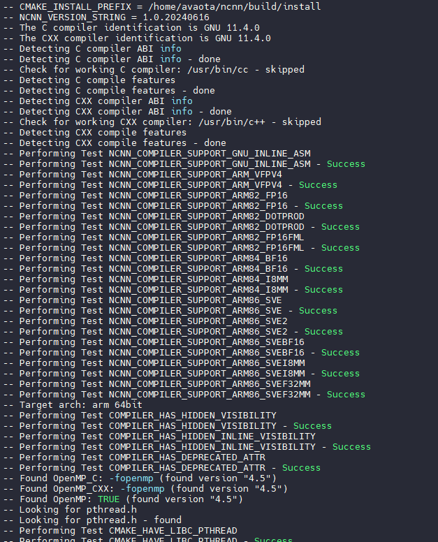

cd build
cmake ..
image-20240616203746494

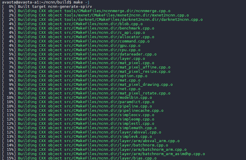

开始编译
make -j6
image-20240616203814748

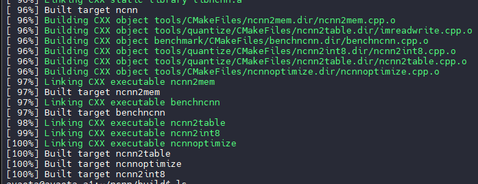

编译完成后,会提示编译已完成
image-20240616212723519
