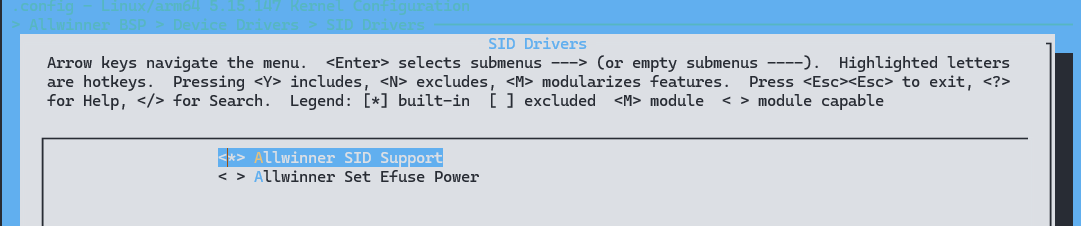

驱动位于
SID Drivers ->
<*> Allwinner SID Support
< > Allwinner Set Efuse Power
image-20240329175507331
