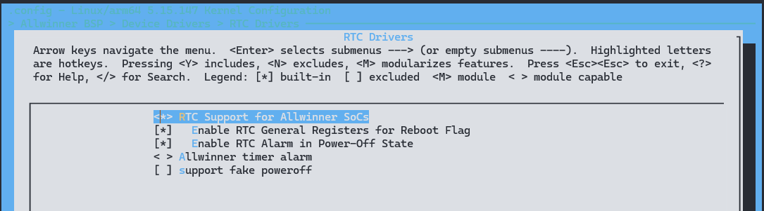

模块配置​
驱动配置​
RTC Drivers ->
<*> RTC Support for Allwinner SoCs
[*] Enable RTC General Registers for Reboot Flag
[*] Enable RTC Alarm in Power-Off State
< > Allwinner timer alarm
[ ] support fake poweroff
image-20240329173720153
