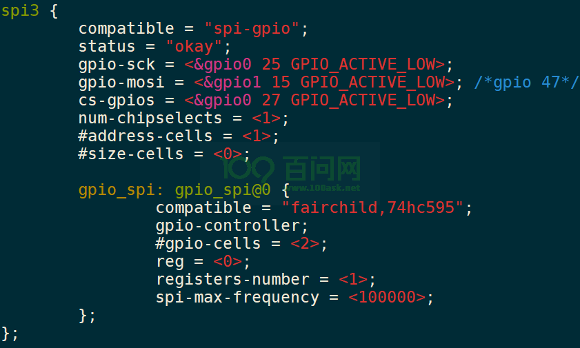

3.1 使用GPIO模拟的SPI控制器​
image-20220217181848873

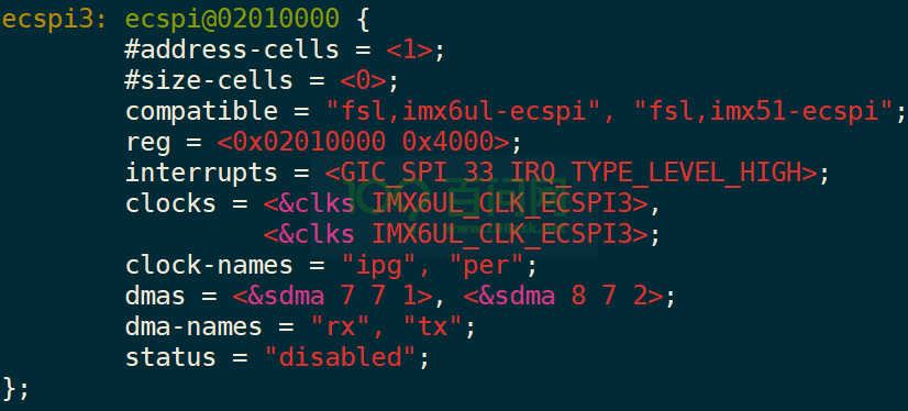

3.2 IMX6ULL SPI控制器​
内核文件:arch/arm/boot/dts/imx6ull.dtsi
image-20220218101204976

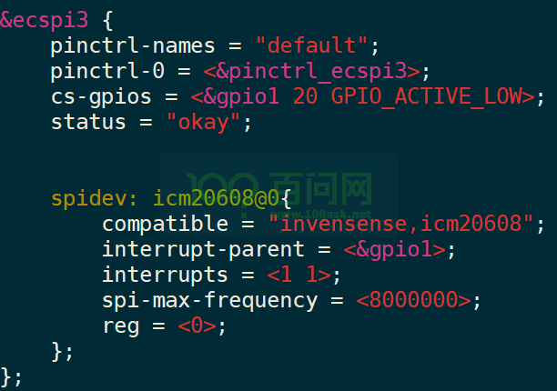

内核文件:arch/arm/boot/dts/100ask_imx6ull-14x14.dts

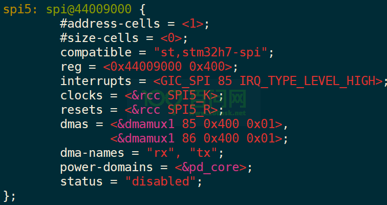

3.3 STM32MP157 SPI控制器​
内核文件:arch/arm/boot/dts/stm32mp151.dtsi
image-20220218104433011

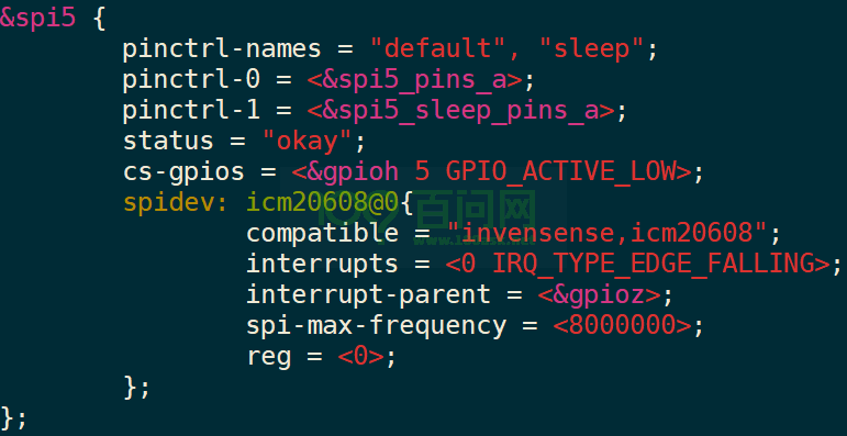

内核文件:arch/arm/boot/dts/stm32mp157c-100ask-512d-lcd-v1.dts
image-20220218104519443

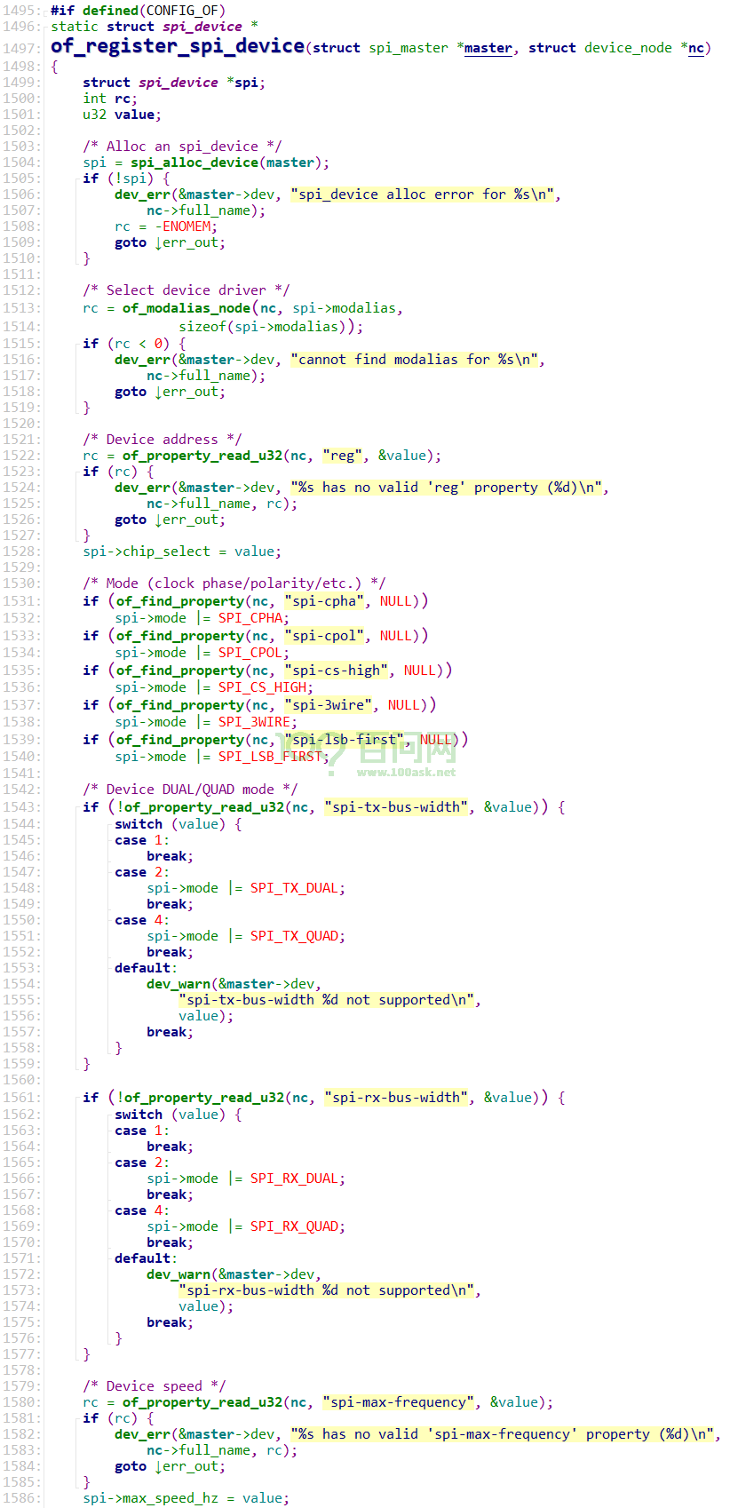

4. 设备树处理过程​
内核源码:drivers/spi/spi.c
image-20220304144624084
