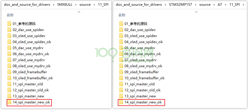

本节源码: image-20220614170117164
  • 内核头文件:include/linux/spi/spi.h
  • 内核文档:Documentation/devicetree/bindings/spi/spi-bus.txt
    • 内核源码:drivers/spi/spi.c、drivers/spi/spi-sh.c
