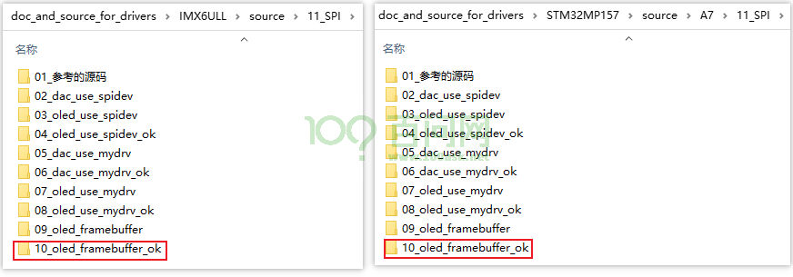

4. 编译OLED驱动​
cd 10_oled_framebuffer_ok
make
5. 编译APP​
cd 10_oled_framebuffer_ok/03_freetype_show_font_angle
make
