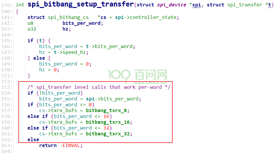

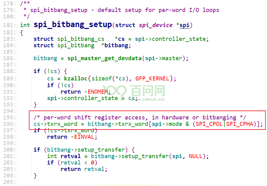

8. spi_bitbang_bufs​
return cs->txrx_bufs(spi, cs->txrx_word, nsecs, t);
image-20220303143723585
image-20220303144759926

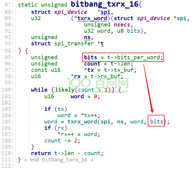

9. bitbang_txrx_16​
image-20220303145227558
上图里的txrx_word来自哪里?spi_master在传输spi_transfer之前要设置。

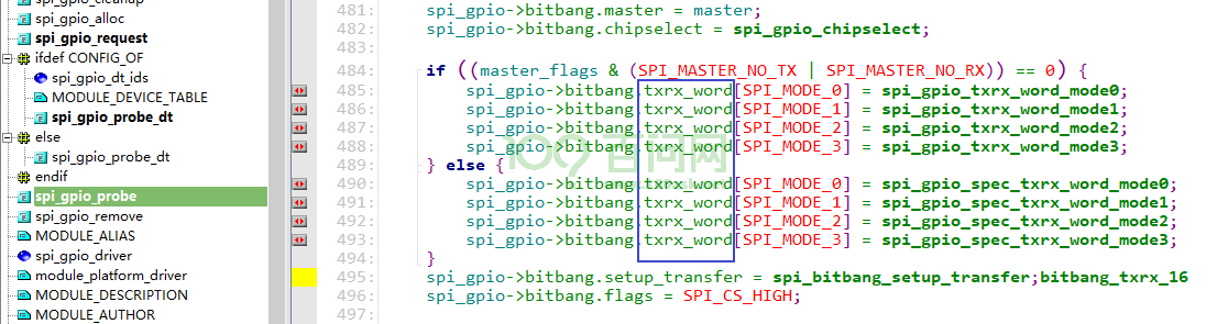

对于SPI GPIO:
image-20220303145416724

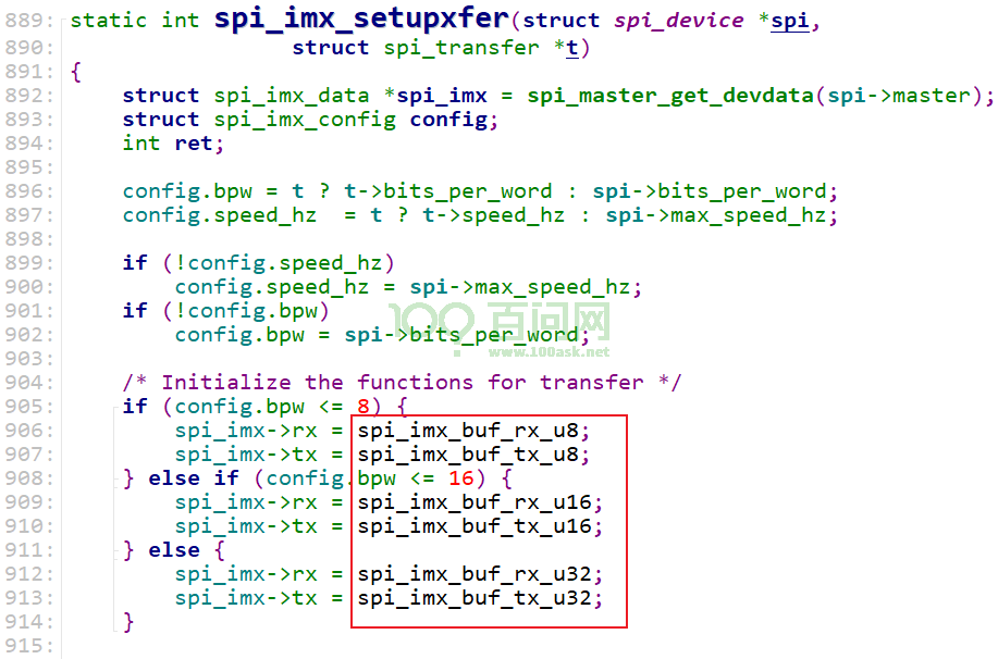

对于IMX:
image-20220303150143475
